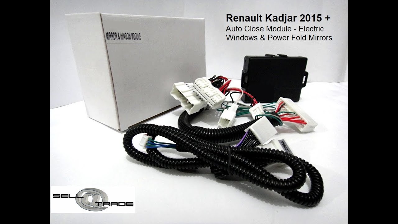

    https://www.ebay.de/itm/Renault-Kadjar-2015-Auto-Close-Modul-Fenster-Tur-Spiegel/263868241160?fits=Model%3AKadjar&hash=item3d6fc5d508:g:mEsAAOSwBRFaTK~1
    Renault Kadjar Auto Close Module for Windows and Mirrors Installation Video
    Sell@Trade - Proudly present an Auto Close Module for Electric Windows and Electric Power Fold Door Mirrors for Renault Kadjar 2015+.This item does the same ...
    www.youtube.com
    Am obigen Video von FG-Freak finde ich 1:31 bis 1:45 am interessantesten.
